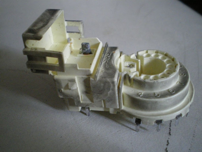

turned out to be oxidation on the high voltage wire connection inside the CRT socket.... replacing the socket did the job! credit however goes to my local tv guy - he told me the humid weather was to blame.
Here's a shot of the old socket - notice all the gunk on the solder post:
